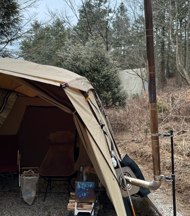

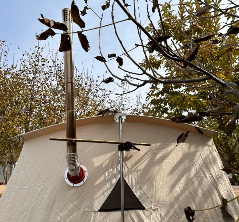

4. Marking & Cutting the Stove Jack
Step 1: Pitch tent, tension guy-lines.

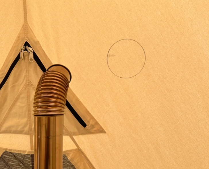

Step 2: Measure 45° upslope from peak (prevails rain drip). Mark center.

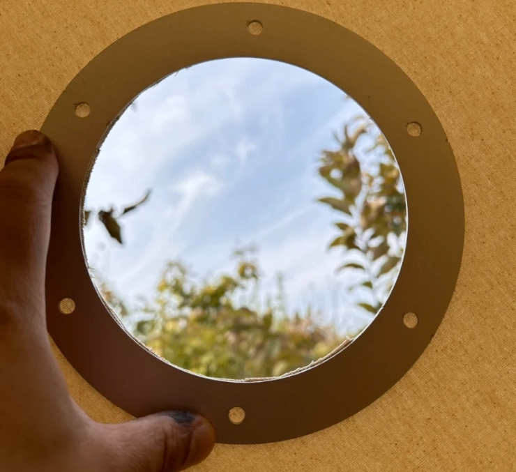

Step 3: Hole-saw 120 mm for ∅75 mm pipe; leave 5 mm edge for collar rivets.
Step 4: Sew fire-proof Aramid patch (included in our FP-KIT) around cut – prevents fray.
5. Sealing the Collar (Video 45 s)

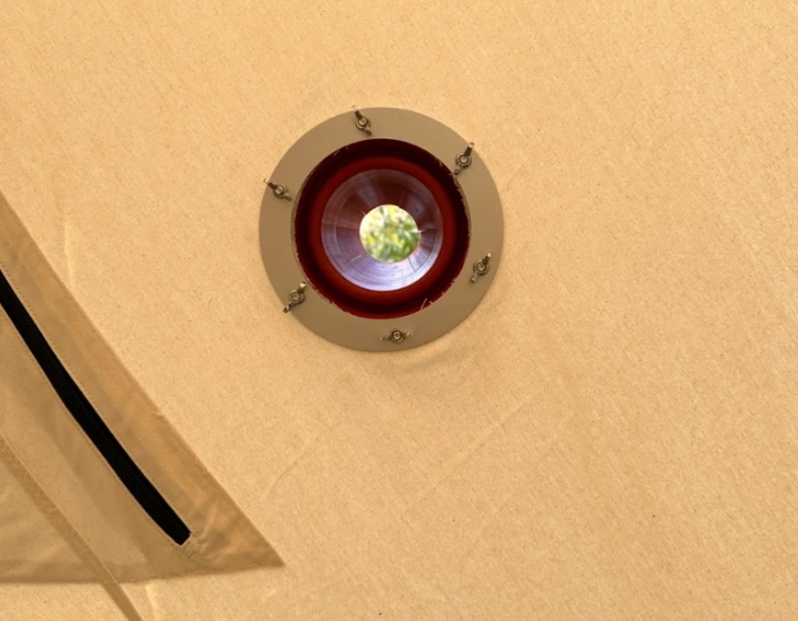

– Slip stainless collar through canvas.
– Back-flange 15 mm, 6 rivets.
– Run 6 mm bead high-temp silicone on both sides.
– Cure 30 min before inserting pipe.

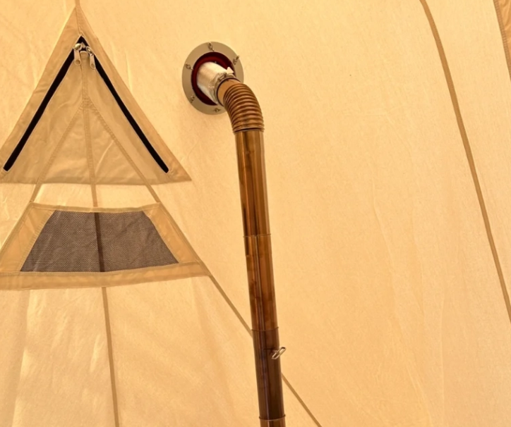

6. Assembling Pipe Sections
Tip: overlap 30 mm minimum each joint – locks draft and adds stability.
Laser-etched alignment line guarantees 0° twist every time (our 2025 update).
Roll-lock seam faces away from wind → 7 % less creosote drip.
